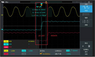

I am using DP83TC812S-Q1 to communicate with MAC which doesn't support eee. It seems that the lpi_exit signal (as descriped in RGMII_EEE_CTRL Register 0x603) is sent every time data is received. Rx_ER on rx_ctrl is assertted but the MAC cannot recognized it. The configuration of this register cannot take effect. Here are my questions:
1. Will the lpi exit signal be sent every time data is received from idle status under the default configuration?
2. Can I stop the eee feature of DP83TC812S-Q1 in rgmii mode and stop the lpi exit signal by software configuration?

  • Hi David
        So the configuration of this register will not take any effect? There is still a lpi_exit signal in my rx data. I wanna know if the lpi_exit signaling exist and can be changed by software configuration.
  • Hi Jiahua,
    Can you please share how you are seeing a lpi_exit signal? This is using wireshark? Please share screenshot if possible.
    Is normal data throughput successful?
    Is EEE enabled on the link partner?
    David
  • I caught the RXCLK,RXCTL and RXDATA0 on the RGMII line between PHY and MAC, and saw the rxdata0 was 0 and RXCTL was up at  falling edge. It matches the lpi_exit signal description, but I am unsure whether it is. It is inconsistent with the format of sfd, so MAC parses the received data abnormally and thinks that a phy error has occurred.

  • Yes, even if a number of frames are sent to the MAC in succession, this phy error is reported for each frame. Regarding the values of the registers you asked about, Reg 0x15,0x63d and 0x63e always remain at 0, Reg 0x63c changes with the number of received messages, which indicates that there are no error packets.
    I think the problem is that d0 always goes low at the beginning, but this should stay at 1 accoding to the header format. Is it possible that though eee is not supported, a signaling behavior similar to lpi_exit still exists?

  • Dear David,
         I did a simple initialization based on datasheet only with the following steps:
    1)write 0x8100 to Reg0 , and wait for soft-reset completes
    2)write 0x2100 to Reg0, work on 100M full duplex mode
    3)write 0x02 to Reg 0x602, MMD1F,  for rx shift mode
         I'm in fpga-based simulation and not using linux OS. I modified my initialization according to your script above, and found that cross-board communication no longer reports errors, although the phy digital loopback is still problematic. The script configures a number of registers, which are not mentioned in the datasheet, so I didn't understand why it stopped reporting errors, and I'm still trying to get my head around the problem and the exact configuration that took effect. So far it seems to be a problem with my default hardware configuration. The script helps me a lot. Here's still giving the register values you mentioned

  • Dear David,
        The issue with loopback communication is also fixed after I updated my testing fpga bitfile , although the problem can be reproduced when I try to update from an older version. I think there is some side-effect while the environment is updating that causes the problem and I can't pinpoint the exact cause just from the registers that are mentioned on the datasheet. In any case the PHY works fine in the latest environment, which solves my core needs. Thanks for all your recent replies
