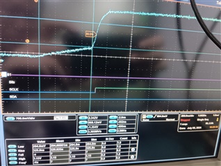

i2c 400Khz,use PCA9306DCUR to trans 3.3v to 1.5V.
but the 3.3v input rise time is not meet 1.5v slave requst
please help me。

    I2C specifies the max rise time of a 400KHz to be 300ns max, which looks to be a violation in the waveform. The concern is that the slow rise time could cause communication errors as the downstream device may not be able to detect the rising edge of the 3V3 driver.
    Note the observed slow rise time is directly impacted by the pullup selection used, as well as how cap. loaded the I2C bus is. Could we try using stronger pullups and also share a schematic for further checks as needed?

  • Our investigation found that buffer affected it and it was ADI LTC4307. Is there any model that is Pin-to-PIN compatible recommended?

  • The TCA4307 also seems to have a precharge function, which doesn't seem to solve our rising edge problem

    I see- thanks for clarifying. If hot-swap is not a requirement, you may also see the TCA980x without the precharge function (this buffer uses an integrated current source on B-side, so no pullups needed on B-side).
