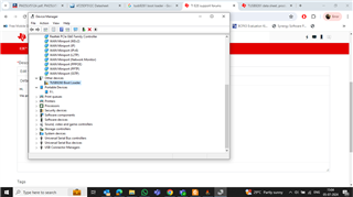

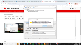

We are trying to update the frimware to the IC TUSB9261 , but failed to load using flash burner.
Please suggest how to load the frimware.

Which version of Win are you using? Can you please disable Windows Driver Signature Enforcement and see if you are then able to install the driver?

Did you try to disable Windows Driver Signature Enforcement and see if you are then able to install the driver?
David

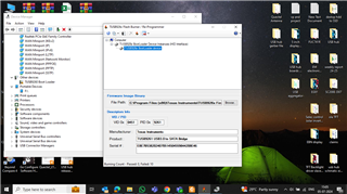

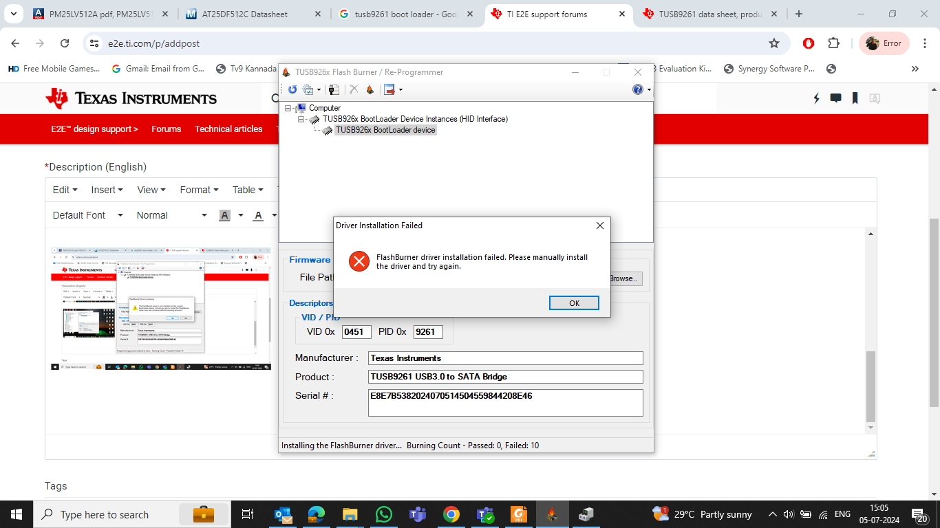

Hi David
Yes i tried with disabling Windows Driver Signature Enforcement, but facing same problem.
Hi Subramanya,
Is this with our EVM or your custom board? What firmware file are you trying to burn onto the TUSB9261? One of the firmware files we provide, or one you modified?
The burner detects the TUSB9261 at least, so given it is not burning, my suspicion is that either the firmware file may not be the correct format, or that the EEPROM being used is not compatible, though my research with the one you named indicates it should be.

Do you have any TUSB9261 schematic? How was this designed, was it based on an EVM or our implementation guide?
Would it be possible to try this on a different OS, such as windows 11 or windows 7, and seeing if the results can be reproduced?
If you could let us know which firmware file it is, we can go into the lab tomorrow and attempt to reproduce the issue on our side, and see if there is an issue there,
