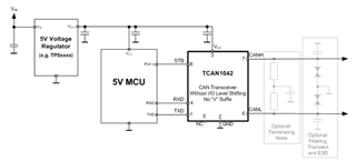

I used below CAN FD chip to create a test PCBA to verify this chip performance,
but I can not send any CAN/CANFD msg when I power supply for this CAN transceiver with 5V,
below is my config:
     - 5V power for PIN3 Vcc
     - STB configured with Low Voltage == GND
     - GND connect with GND of battery
     - TXD connect with MCU TXD,  <-- verified this pin voltage is 4.9V
but CANL and CANH verified is 0V;
No messges is occured in CANoe trace;
could you do me a favor and help me clarify where is the isuue

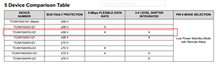

    I selected this chip TCAN1042GVDRQ1, maybe below red mark one;  I prefer this one is because the CANFD capability though not use 3V level shifter;

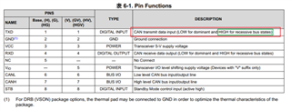

    I checked data sheet, maybe the the green marked could explain my confusing,
    anyway very thanks your answer!

  • Hi Dawei,
    The G suffix represents the device can support up to 5Mbps (2Mbps on non-G device), V represents the device support level shifter so it has a VIO supply on pin 5 (NC on non-V device). You still need to supply VIO with 5V even if 3V level shifter not used. The TCAN1042GV-Q1 will not work if VIO is not supplied. Can you please check if VIO is also supplied 5V?
    When you input a 5V on TXD, the output on CAN bus will be recessive, however the voltage level should be at common mode 2.5V, not 0V.
    Sean
