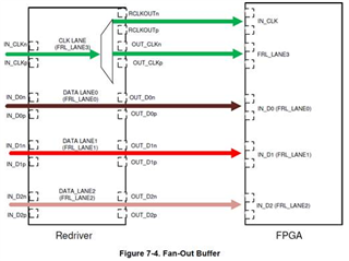

Hi team,
Only CLK_LANE has MUX to output RCLKOUT and OUT_CLK though IN_Dx to OUT_Dx don't have. Is there any skew between CLK lane and DATA lane?
If it is characterized, please let me know where it is.
Hayashi
Hi team,
Hayashi
Hey Hayashi,
There is no concern with the skew being out of spec for HDMI2.1.
