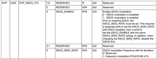

    3. Do we have recommended slew rate configuration considered to meet EMC performance?
    For the UB933 and UB934, SSCG is an available configuration on the UB934 via the following register.
    This would apply SSC to the back channel of the UB934 but, not the UB933.
