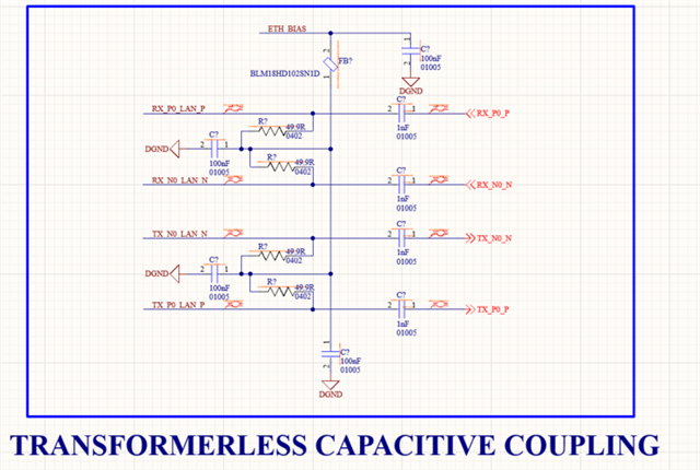

Does AN-1469 PHYTER Design & Layout Guide apply to DP83867E? In the app note it doesn't specifically call this part number out but I want to check.
If I cannot do transformerless capactiive coupling with DP83867E, can you please suggest a PHY that can handle that and is compatible with the AM62A74 Sitara microprocessor.
