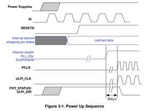

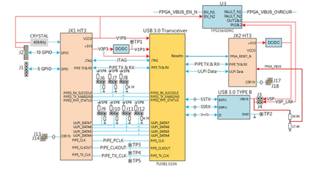

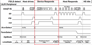

We got some problems about using TUSB1310A PHY as a peripheral when it work with a USB2.0 controller in device mode.

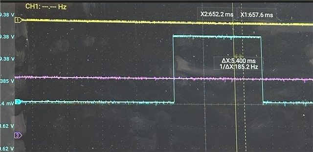

The D+ was not asserted high when we insert to the PC USB Host , even if we can detect that the VBUS PIN on the device was 5V, and PWRPRESET is assert high.

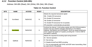

Now, USB controller send tx_cmd(0x84, 0x45) to PHY,  0x45 is mean Opmode = 00b for normal operation
