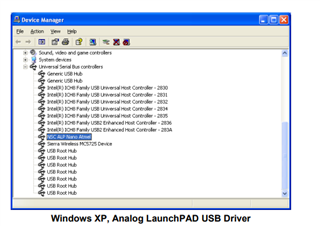

“Universal Serial Bus Controllers” as shown below but I do not have it on my computer
The Nano driver is not from TI. It's a Cypress driver and supports Win10. The instructions to download and install it are in the ALP install folder listed below.
C:\Program Files (x86)\Texas Instruments\Analog LaunchPAD v1.57.0010\ALP_Documents\ALP-92x-Driver-Install
If you don't find this folder in your machine, please make sure you installed the latest ALP-PROFILE-UPDATE (v10) from TI.com in addition to the ALP frame work. Then only you will see the above folder. Also, then you will have the latest ALP profile updates on your machine.

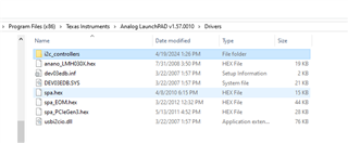

Hi Fadi,

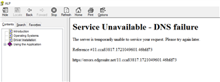

I have the latest ALP-PROFILE-UPDATE(v10) from TI.com. The links (shown below) on the pdf instructions from the ALP install folder do not work.
Driver installation instruction pdf on ALP help
first link result (multiple pop-up message box)
second link result
Could you share the link for the driver download that works.

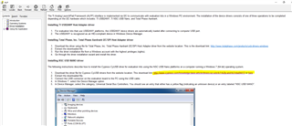

Hi Sarala,
When you search this link on your PC do you see this PDF file attached below?
If not, that means your ALP profile is not updated.
Here is the PDF you should be seeing that has instruction on how to install the drivers.
5658.ALP_92x_EVM_Driver_installation.pdf

I follow the instructions on the pdf file (you shared the same pdf file ).
This is what I see on my ALP tool (as per the pdf instructions)
The links are broken. Can you provide me the right link to download driver file for Cypress CyUSB drivers?
The first link content is archived (I copy paste the link in the browser )
The second link result is attached in my previous response.
I repeat, I have the right ALP profile. Please share the working link to download driver file for Cypress CyUSB drivers.
