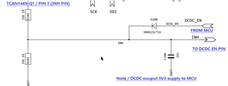

Here is question about Window watch dog of TCAN 1469-Q1,
Basic requirement:
a/ use INH pin as enable signal of DCDC ( DCDC output 3v3 supply to MCU)
b/ Window Watch Dog is needed for whose system
As far as I know watch dog reset signal is also via INH pin (turn off INH 300ms) , so I am worry about whether the 2 functions is contradictory via INH PIN in my system or what shall add in current design?
My concept like below : my MCU power supply's enable signal is come from INH signal 1st , afterwards the MCU is work , then the MCU will generate a separate enable signal for MCU power ,
Please help to evaluate it, Thank you!

    I'm not sure I understand why the MCU needs to provide its own enable signal to the DCDC. Could you help clarify the intent of this line "FROM MCU"?
    Danny
  • Dear Danny,
    I am afraid of the bus sleep message can't be received by MCU before INH goes to low, so I added enable signal from MCU to ensure all staffs are ready before goes to sleep mode.
    By the way , I would like to ask what state of INH after power on when MCU has no software ?
    Thank you !
  • Yi,
    Initially the INH will be high because the device will be in Standby mode.

  • Yi,
    The behavior from the flowchart in Figure 8/26 depends on your configuration of WD_ACT. If WD_ACT = 01b, then it will follow the path downward on Figure 8-26. Note that this only happens if the watchdog counter is exceeded.
    The purpose of toggling INH for 300ms is to reset the system if a large failure has taken place. This would toggle the power state of the voltage regulator, since INH is intended to control the system power state.
    Danny
  • Dear Danny,
    Therefore, there is no contradiction between these two functions (WG / Enable signal of system power). If the watchdog counter exceeds its limit, the entire system will be reset and then recover after a duration of 300 ms.
    Am I understanding this correctly? Thank you!
    Thanks!
  • Yi,
    Yes, it sounds like you are understanding correctly. Slight smile
    Of course, please let us know if any other questions come up.
