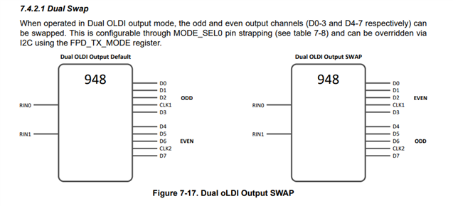

May I know the DS90UB948-Q1 support the LVDS output paths swap for layout issue?
My customer would like to swap the D6+ to CLK2+, D6- to CLK2-, does not change the signals polarity swap.

Hi Henry,
There is no polarity swap function on the UB948. The only LVDS channel swap supported on the UB948 is "Dual OLDI Output Swap" shown below.
