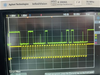

We could able to view data and clock waveforms when executing i2c commands. whenever we use i2cdetect commands, its showing like no device is connected on the bus 0. please see the below details.

  • Hi Aravind,
    Do you have I2C waveforms with digital analyzer so we can distinguish if there is activity on the I2C bus?
    Logan
    Here i have attached the I2C waveforms...we received NACK from the slave address of 0C
    Also we have one working board..please have a look
    Aravind
  • Hi Aravind,
    It looks like there is no ACK in the failure case. Can you confirm that the SER is actually PDB=High during this time? Otherwise, can you also confirm the setpoint of the IDX pin, which determines the device address for the SER.
    Logan
    PDB is high at this time..and IDX pin is configured such that for i2c voltage level of 1.8V.. R1 pullup resistor is open and R2 pulldown resistor is 10K hence 0X0C is our Slave address..we received low at this pin
  • Hi Aravind,
    There does not appear to be any gross issue on the I2C transaction itself when you get this NACK. Pull-down strength looks to be proper threshold, device address is the same as passing case, etc.
    Can you provide a waveform of the power-on sequence? Maybe the device is getting improperly strapped or some other issue.
    What is the success/non-success rate of the transactions? Is it only some power cycles that it works, or every transaction has a chance of ACKing?
    Logan
  • Hi Logan,
    The I2C issue has been resolved. we have found that One of the VDD pin is not properly powered.Now, I2C protocol is acking properly.
