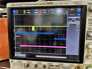

We are encountering a random issue in few of our custom hardware boards, where their is no output on the LVDS Display.
We read the Error Register 0xE5 in both working and non-working setups, and our observation is -
  1. On working setup, where display works seamlessly
    1. 0xE5 register value is 0x01
  2. On non-working setup, where display is blacked-out
    1. 0xE5 register value is either 0x0D or 0x09
PFA the IC initialization sequence.
reg data
0x09 0x01
0x0D 0x00
0x0A 0x05
0x0B 0x10
0x10 0x26
0x12 0x28
0x18 0x18
0x19 0x00
0x1a 0x01
0x20 0x00
0x21 0x05
0x24 0x00
0x25 0x03
0x28 0x20
0x29 0x01
0x2C 0x0c
0x2D 0x00
0x30 0x03
0x31 0x00
0x34 0x10
0x36 0x08
0x38 0x3c
0x3A 0x10
0x3C 0x00
0x0D 0x01
