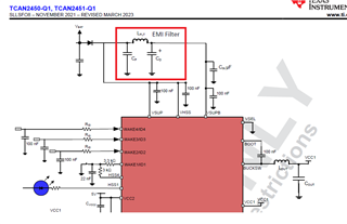

TCAN2451-Q1: I would like to get the suggestions from TI about power supply of TCAN2451-Q1
Part Number: TCAN2451-Q1
Hello TI expert
I hope to get the recommending values for below CF, CD and LFLT.

  • Hello Danny,
    Table 9-1 in the full data sheet is as below.  But it did not solve my problem.  Are you sure the table 9-1 is correct?

    Also, it is possible that the older document you're using has this table marked as Table 10-1, though I cannot be certain because your screenshots are from an unreleased version. It might be titled "Recommended External Component Values." If you cannot locate this table in your version, you will need to access the released data sheet from the link shown above.
    That being said, common values for a pi-filter include ~1.5µH for the inductor and ~2.2µF for the filter capacitor CF. The larger capacitor depends on the size of CIN in your schematic, which is shown as C5 in the released data sheet.
