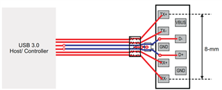

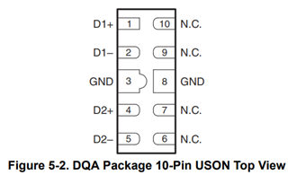

"Could you please clarify if it is okay/expected to connect USB 3.0 signals to the NC pins?
The datasheet for TPD4EUSB30 has the following pinout:
In the same datasheet, the recommended layout clearly has the USB_TX/RX diff pairs following through the NC pins.
A prompt answer to this question would be greatly appreciated!"
