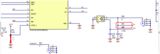

As the reference design, why the resistor R97 is 100ohm? it is 0 ohm in most of design. thanks

I will discuss this query with the internal team who designed this board and get back to you with response.

Please refer to this Open Alliance application note where we recommend 100 ohms on R_Xi:

Hi Avtar
Thanks for your reply.
It only told me to use 100 ohms, i still do not understand why, like which test item may be fail with 0 ohm?
Bruce
Hello Bruce,
These are rule of thumb recommendation for passing Open Alliance compliance testing, we do not have exact data on what tests will fail if using 0 ohm R_XI but 100 ohm is recommended. Are compliance tests failing currently when using 0 ohms R_XI?
Avtar
Hi Avtar
We did not see any failure until now, but we only tested PMA and EMC, we better follow the recommendation. thanks.
