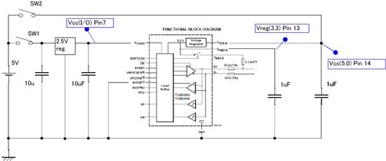

I have a question about output status from Vreg(3.3) which is regulated supply voltage output.
On my hardware, output from Vreg(3.3) always stay in "High-z" irrespective of supply voltage to Vcc(I/O).
That means configration can't be dynamically changed between disable mode and normal mode.
I used in Internal Regulator Mode, and tested following steps;
Step1: Supply 5V to Vcc(5.0) (This 5V is powered from the Vbus line directly.)
Step2: Supply 3.3V to Vcc(I/O)
Output from Vreg(3.3) is in "High-z".  I confirmed output from Vreg(3.3) is in "High-z" on the step1, and it keeps same state on the step2.
Why output from Vreg(3.3) always stay in "High-z"?

    Sorry for the delayed response. From your description of the problem, it sounds that it might either be a failed part or it could be the the device is in the incorrect mode due to something about the way it is connected.
    you could try replacing the part with a different unit and if the problem still persists, please send a schematic that we can review.

    I'd like to make sure that the internal voltage regulator produces 3.3V in disable mode?
    (Disable Mode:  Vcc(I/O) is not connected, Vcc(5.0) is connected.)
    I'm still facing same problem that the internal voltage regulator produces <1V where Vcc=5.0V, Vcc(I/O)=2.5V.

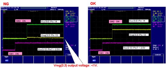

    Am I understanding correctly that the you get the 3.3V output with certain pcs of the TUSB1106 and not with others?
    Between the NG and OK scope shots you have shown, is there any difference in the circuits?

    I checked Vreg voltage only on TUSB1105. (not on TUSB1106)
    On my verification, I get 3.3V Vreg output correctly on 84pcs, but 14pcs output below 1V in spite of connection both Vcc(5.0) and Vcc(I/O_2.5V).
    There is no difference in the circuit between NG and OK scope.
    On the NG parts, I get 3.3V Vreg voltage successfully on the first start-up.  However, it produces below 1V on the second start-up.  I can't understand why NG parts produce different Vreg voltage even though same circuit.
    My purpose is to make clear below;
    (1) Root Cause - Is this problem due to circuit?  Why this problem occur?
    (2) Find a Solution - Is there any solution not to occur this problem?
