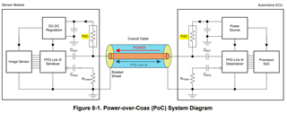

We are performing the BCI for the serializer (DS90UB933-Q1). Could anyone please share the PDN network for the LVDS line.

  • Hello Pavan,
    If you are looking for a PoC Network to transfer DC current to a remote serializer/camera module for power, then I expect the overall system to look like below:
    A PoC network that you can use for this purpose for the 933 is one of the example 2G POC networks listed in our datasheets:
    Make sure that the DC current sent through the PoC Network does not exceed the saturation current limit of the inductors used in the system and that the FPD3 Channel Specifications can be met in your system.

  • Hello Justin,
    Thanks for the inputs shared. The POC filter is already implemented in the circuit. I was looking for the PIN and Package RLC parameters of the pins as they are not available in Ibis model.Could you share those details if available.
