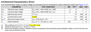

Hello.
I am going to calculate the internal impedance with reference to Electrical characteristics of this device.
Internal impedance is 27.5kΩ(=5.5V/200uA) (Min)
Internal impedance is 366.6kΩ(=5.5V/1.5uA) (typ)
So from Vcc=5.5 V, 27.5kΩ(Min)~366.6kΩ(typ) to vary.
 Is my understanding correct?
Please let me know if I'm wrong.
