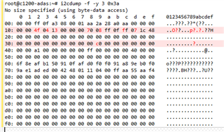

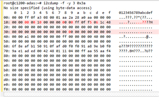

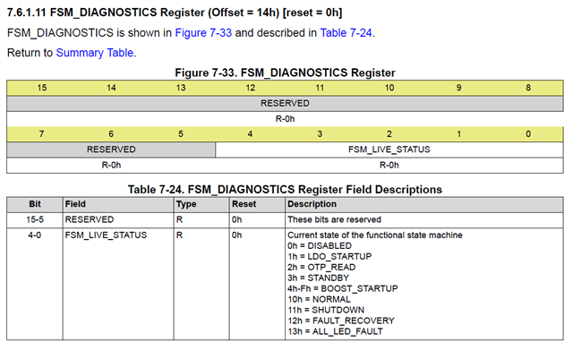

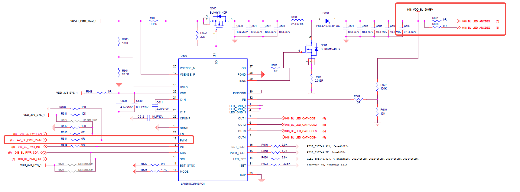

Set gpio2 to Remote GPIO Control, output pwm to a backlight driver IC (LP8864SQRHBRQ1), the backlight flashes for a moment, and then no light;
The power output of the measurement backlight chip (LP8864SQRHBRQ1) disappears at 20v and is synchronized with the time point given by pwm;
PWM and output voltage, as shown in the red box below:
What are the possible reasons? How to debug
