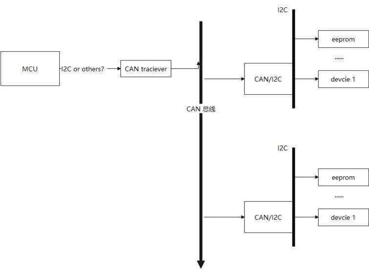

Hi team,
can you help to see if the TCAN3413 support below application? or do we have relevant device to support the transceiver function?
  • Hi Dane,
    From a physical layer perspective, there is no problem using TCAN3413 for this topology for use with other 3.3V or 5V supplied transceivers or mixed network of both. From a protocol layer, there are some considerations to account when using I2C over CAN. Please see the reference guide linked below for more information. If the protocol used here is CAN, then there will be no extra considerations needed here.
    https://www.tij.co.jp/jp/lit/ug/tiduei0/tiduei0.pdf
    Let me know if you have any more questions.
    Eric Schott
  • Hi Eric,
    thanks for the reply. some question below:
    1. do we have CAN relay product to support the compensation for the cable loss?
    2. is the Transceiver has the compensation function?
    3. what we recommend for server application where there is CAN?
