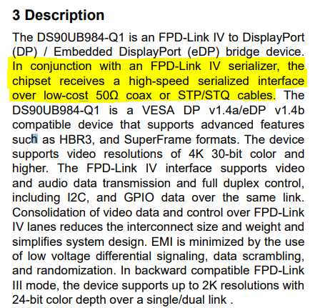

    GMSL serializers are not compatible with FPD-Link deserializer. MAX96717 should not be connected to a 984MEVM. I would recommend you to use an FPD-Link Serializer such as DS90UB983-Q1 which has DP input or DS90UB981-Q1 which is a DSI input.

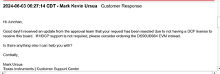

    also before I purchase this EVM board, TI also give me the suggestion. show as below.
    I bought 2 piece of this Board, the first works well,  but the other does not work.
    if so, do you have any suggestion? return back to TI for checking?
    The FPD-Link Deserializer is only compatible with FPD-Link Serializers. GMSL uses a different protocol that is not supported by our devices.
