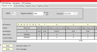

    Connect to slave board with DIEP tool, set register 0x018B to 0x0180
    Set wake pin low by moving jumper J3 to the "right" / GND position
