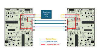

We are using TLK10232 in one of our designs, which can be summarized with the next diagrams:
Mode of operation 1 (10GBASE-R):
We managed to make this mode work by finding the most suitable equalization parameters for our system, after following the bringup procedures.
Mode of operation 2 (1000BASE-X):
In this mode we don't need to pass through the FPGA, so we thought that the fastest way to achieve 1000BASE-X regeneration was to enable the DST switch setting the reserved bits 30.23.4:0 (DST_FORCE_SEL) to 0b11000. This sets the dataswitch configuration like the next image:
The LS side would be unused, although the FPGA might be driving the LS lanes (IN) with XAUI data.
We are struggling to make this mode work reliably. We can leave a test (see image below) for 60+ hours with no issues, but if we disconnect/connect the LC connectors in any of the SFP modules several times, the system ends up not being able to leave KX_RX_FAULT state and the communication is broken.
We have monitored HS_CHANNEL_STATUS_1 (30.15) register and we see the next values:
HS_DECODE_INVALID 1
HS_CHANNEL_SYNC 0
KX_RX_FAULT 1
Most of the time we solve the problem by issuing a datapath reset, but it isn't guaranteed to work always.
Any idea on what could be causing the issue?

    So far we have performed a test following the next procedure:
    1. Set ST pin to 1 (clause 22) and set MODE_SEL pin to 0 (1G mode).
    2. Reset using reset pin. Sleep for 1000ms.
    3. Write 0 to SW_DEV_MODE (30.1.10) and SW_PCS_SEL (30.1.11) in CHANNEL_CONTROL_1 register for both channels.
    4. Select test pattern writing 011 to 30.11.10:8 (CRPAT Long).
    5. Enable test pattern generation and verification writing 1 to 30.11.12 and 30.11.13.
    7. Sweep sync_status_check_disable, cdrfmult, cdrthr, h1cdrmode, pkdisable, entrack, eqpre (we are skipping AGC control). For every set of parameters we do the next steps:
    1. Write the configuration. Issue a datapath reset and sleep for 1000ms.
    2. Wait until HS_TP_STATUS (30.15.15) is 1.
    3. Read CHANNEL_STATUS_1 register (30.15) once to clear any latched value.
    4. Read CHANNEL_STATUS_1 register (30.15) every 1ms and accumulate the flags hs_errors, pcs_tp_errors, hs_pll_errors, hs_los_errors, hs_az_errors, hs_sync_errors, hs_agc_errors, each one in an independent variable. We also monitor TX/RX FIFO over/underflow, although we don't consider these flags to discard a config.
    5. Sweep to next parameter set once 20 minutes have elapsed of 50 errors are read in any of the variables in the previous step.
    Using this method we find several combinations that give us no errors. But I find it suspicious that not a single set is reporting HS_ERRORS. Are we doing this correctly?
    Regards.
    Manu.

  • Dear Lucas,
    Just an idea to support the previous comment.
    We would suggest you please perform the following experiment. It is similar to our real setup. (The main difference is that we also have an optical path, instead of coaxial cables, in the communication between nodes).
    Note the red lines are performed as loops inside the TLK (data switch).
    For us it is quite difficult to get a working link with no errors. Even using only one TLK (half of the setup), it takes several reset attempts (in the datapath) and it is not deterministic. If we go to the real case with two TLKs, it is even more difficult, because apparently reseting in one side translates into losing the path in the other end TLK.
    In any case, once you are able to reach a stable link with no errors, please proceed in the following way: unplug and plug the fibre a repeted number of times. In our case, recovering the link looks random. We have to reset the datapath an unknown number of times until the TLKs at both ends recover the link.
    If you get the experiment running properly, also pluggin and unpluggin the fibre, we would appreciate to know your configuration parameters.
    Thank you,

    I understand that the issue was not reproduced when you used setup #1, suggesting the data switch configuration may not be the root cause. I also understand that setup #2 would take quite a bit of time and effort to setup.
    Unfortunately I cannot perform the experiment you outlined. I do not have necessary equipment available in my lab to use.
    • I do not have optical fiber, modules, or loopbacks.
    • I only have one TLK10232 EVM board.
    With the equipment I do have, I can try to reproduce the following behaviors. Please let me know if you believe these experiments will be helpful.
    • Check for BER stability after issuing a datapath reset in 1G-KX mode.
    • Use a HCB in the SFP cage. Check for BER stability after repeatedly plugging/unplugging the HCB.
    • Try to reproduce these issue with and without routing HS channel A to HS channel B internally.
    Lucas
