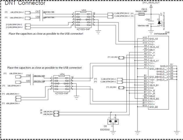

TUSB8041: Request for Power-up timing and schematic review
Part Number: TUSB8041
Other Parts Discussed in Thread: TUSB522P,

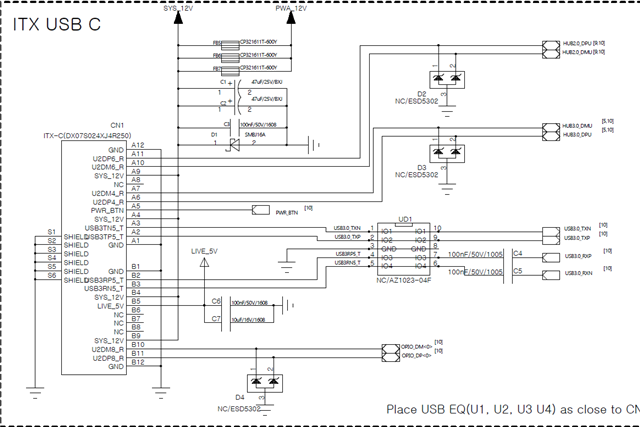

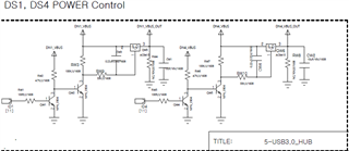

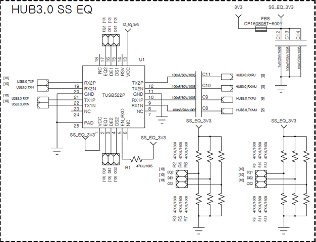

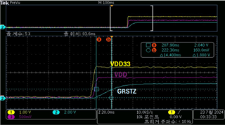

Hi Team,
This device is not recognized intermittently on the device manager. So please let me know if there is a issue on power-up timing or circuit design after checking the attachment below.
5265.TUSB8041_Schematic.pdf
