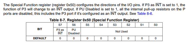

Hi team,
I have a customer with the below inquiry, see below for the full excerpt. Let me know what you think and thanks in advance!
"We noticed this blurb in the TCA9536 datasheet that the pins have a “weak” pull-up during power on. This could cause serious issues for us since the expectation is that GPIOs are either low/high-Z be default.
Im curious what TI’s recommended implementation is since I would suspect many others would also run into issues having GPIOs default high. Adding external pull downs (<10 kohm) appears to be the only solution but this would cause constant leakage through the resistor when we eventually want to toggle them high. Any suggestions?"
