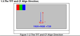

    According to the requirements of the screen, it should be set to Dual-pixel mode.

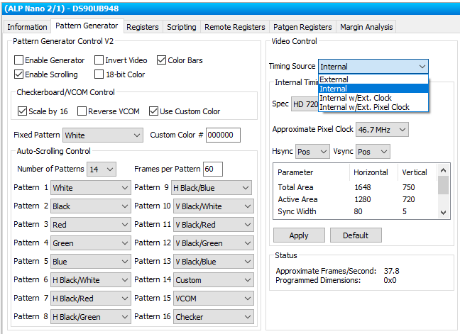

  • Hi Tao,
    Have you verified the timing via PATGEN on 948? It is recommended to first start with DES pattern test, verify the target timing and no system-level display-side issues, then work back towards SER side by doing SER pattern test, then finally OLDI end to end from. I would recommend the following steps for video control/timing source:
    1. Deserializer PATGEN
      1. Internal - Internal timing source / Internal PCLK
      2. Internal timing source / External PCLK
      3. External - External timing source / External PCLK
    2. Serializer PATGEN
    Josh

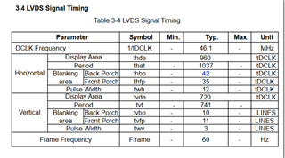

  •  Hi Tao,
    Could you clarify about horizontal blanking? It should be double because it is from 960 to 1920? Are you trying the pattern generator with internal timing?
    In the meantime, please check the app note that is provided the configuration examples (custom display configuration or external clock example configuration): Link
    Josh
  • Hi Baik,
    Confirmed with panel supplier, the lvds timing shown as below:
    panel-timing {
    clock-frequency = <93657420>;
    hactive = <1920>;
    vactive = <720>;
    hfront-porch = <70>;
    hback-porch = <84>;
    hsync-len = <24>;
    vsync-len = <3>;
    vfront-porch = <11>;
    vback-porch = <10>;
    vsync-active = <0>;
    hsync-active = <0>;
    And I did the pattern test(custom display configuration) on 948 refer to app note.

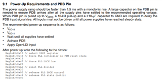

  • Hi Tao,
    The PATGEN programming is right for the desired timing. Could you please check if the code mentioned in 947 has been written? The code is required to follow the power-up sequence. You can see this thread for your reference: Link
    Josh
