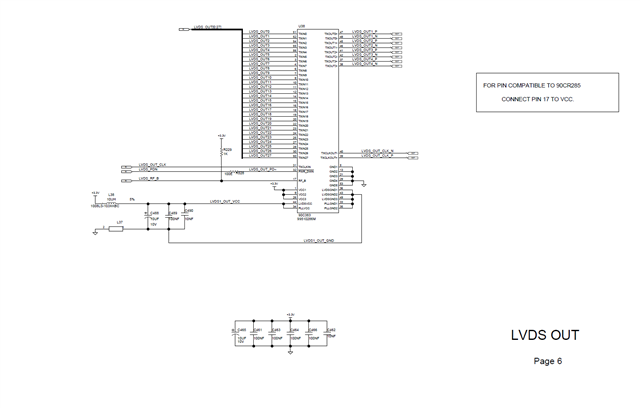

Hi Team,
Im using our DS90C382 device in order to convert RGB to LVDS,
Im inserting a clock with reasonable jitter – 200ps but at the output, they are seeing around 600ps of jitter.
Even after improving the input jitter i still see relatively high jitter at the output.
Do you have any idea why this is happening and how we can face this issue?
Thanks!

    I will try to explain the system setup better:
    We are sending to the device RGB data directly from the FPGA,
    when measuring the jitter to the input of the device on the diff clock we see 200ps of jitter.
    when measuring the jitter at the output of the diff clock we are measuring 600ps of jitter (needles to say that there is termination resistor of 100 Ohm)
    when using a different device to make sure ours isn't malfunction we are getting the same results.
    what could be the issue?

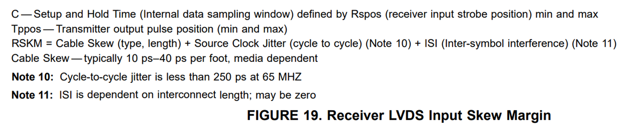

    How are you measuring the jitter? Is this cycle to cycle jitter, TIE, period jitter?
    The datasheet does define cycle-to-cycle as less than 250ps at 65MHz. Note that ISI can also affect jitter depending on the interconnect.

  • Hi Jack,
    we have pulled up the clock legs to make sure that we are having perfect matching, and we still see 600ps jitter at the output.
    the jitter is seen as black and blue dots on the screen and smudged picture as can be seen here:
  • Hi Ohad,
    Thank you for the schematic and the display picture.
    What does this mean exactly?
    What type of jitter are using measuring (cycle-to-cycle, period, etc)?
    Can we get the video source to output a set pattern? I see black dots in the "FAIL" regions but everything else looks fine.
    Are the LVDS signals sent directly to the display? Also, do you know the video PCLK in this case?
    Jack
