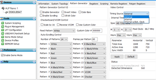

    Also, which mode are you trying to switch to? External or Internal with external clock?
    Fadi A.
  • Hi Fadi,
    The display functions properly when the video source is directly connected to the panel. I believe such an issue is not related to the video source.
    Firstly, I would like to attempt the mode with an external clock and internal pattern (UB947 reg 0x65 = 0x0c, reg 0x64 = 0x05). I examined that the value read from reg 0x5A is 0x12. It appears that UB947 is operating abnormally. Consequently, UB947 (reg 0x5B = 0x03) is not locked to the external OLDI clock.

  • Hi Kexiang,
    For internal timing with external clock mode you still need to program the internal timing - Please see example script below. If this doesn't work that mean you have an issue with your SoC clock since this mode uses an external clock to generate the pattern. So if you don't see Lock or video that means your external clock has some issue.
    #Setting up internal CLK divider to 100Mhz (This only applies to internal timing mode)
    board.WriteI2C(Ser_addr,0x66,0x1A)
    board.WriteI2C(Ser_addr,0x67,0x01) #M=1
    board.WriteI2C(Ser_addr,0x66,0x03)
    board.WriteI2C(Ser_addr,0x67,0x02) #N=2
    #Setting up Display Timing based on Customer Panel
    board.WriteI2C(Ser_addr,0x66,0x04)
    board.WriteI2C(Ser_addr,0x67,0x72) #least 8 bit of Total Horizontal frame size
    board.WriteI2C(Ser_addr,0x66,0x05)
    board.WriteI2C(Ser_addr,0x67,0xE6) #Least 4 bit TV + Most 4 bit TH
    board.WriteI2C(Ser_addr,0x66,0x06)
    board.WriteI2C(Ser_addr,0x67,0x31) #Most 8 bit of Total Vertical frame size
    board.WriteI2C(Ser_addr,0x66,0x07)
    board.WriteI2C(Ser_addr,0x67,0x00) #least 8 bit of active Horizontal frame size
    board.WriteI2C(Ser_addr,0x66,0x08)
    board.WriteI2C(Ser_addr,0x67,0x05) #Least 4 bit AV + Most 4 bit AH
    board.WriteI2C(Ser_addr,0x66,0x09)
    board.WriteI2C(Ser_addr,0x67,0x30) #Most 8 bit of active Vertical frame size
    board.WriteI2C(Ser_addr,0x66,0x0A)
    board.WriteI2C(Ser_addr,0x67,0x28) #Horizontal Sync Width
    board.WriteI2C(Ser_addr,0x66,0x0B)
    board.WriteI2C(Ser_addr,0x67,0x05) #Vertical Sync Width
    board.WriteI2C(Ser_addr,0x66,0x0C)
    board.WriteI2C(Ser_addr,0x67,0xDC) #Horizontal back porch
    board.WriteI2C(Ser_addr,0x66,0x0D)
    board.WriteI2C(Ser_addr,0x67,0x14) #Vertical back porch
    #Setting up External Timing with External Clock
    board.WriteI2C(Ser_addr,0x65,0x00) #using External Timing/CLK
    board.WriteI2C(Ser_addr,0x64,0x15) #enable PG/color bars
    Fadi A.

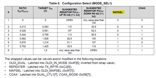

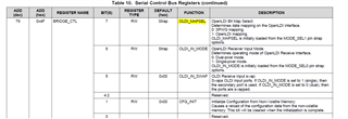

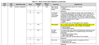

  • Hey Kexiang,
    It appears that the external LVDS control signals (DE/VS/HS) are not aligne with internal pattern.  Is there any specific format for the LVDS input ?
    No, you shouldn't need to change any settings or format between internal pattern and external CLK mode (0x65 = 0xC0) and external timing/CLK mode (0x65= 0x0) except for register 0x65 value.
    So if you are not seeing an issue with internal timing and external clock mode and seeing HS/VS/DE issue with external timing/CLK mode then this points to a timing issue coming from the video source.
    The only thing you can change is MAPSEL from Mode_Sel1 pin strap or register override. You can also check the filter enable setting in register 0x03 which should be enabled by default.
    However, in MAPSEL issues you will have some discoloration, etc. but in your case with flickering screen/flashing this seems to be a more of a hardware implementation for the data lanes as well to ensure 100 ohm is applied to all lanes and make sure the SoC or video source has a stable video output.
