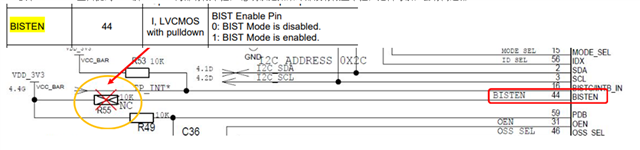

Customer should not leave this pin floating. The internal pull down resistor is weak pul down resistor.

Thank you for your feedback . If add an external pull down , it will impact the PCB and the modification is not easy. So we want to know what risks would occur if let this pin floating ?

They always have external clock, but I want to know how this connect to BISTEN pin floating?
My customer want to know what risks would occur if let this pin floating, when does a misjudgment occur?

No pins should be left floating if they are not used. The internal pull down resistors are weak and could lead to pin getting some noise that could lead to unexpected behavior or current leackage etc. I would strongly suggest to use an external pull down.
