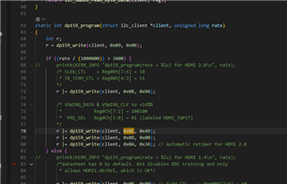

Part Number: SN65DP159
Should that set -2 dB de-emphasis or 0db?
What is this related to?
thx for your reply
The TX de-emphasis is to pre-compensate for the channel insertion loss. I would set it to 0dB first, and if needed, set to -2dB depending on the HDMI electrical compliance testing result.
David
The setting of de-emphasis is system dependent, and can be tuned if needed to pass the HDMI electrical compliance testing.
David
