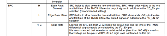

SN75DP139: waveform tuning by SRC level
Part Number: SN75DP139
Hi
My HDMI waveform is eyediagram is not meet spec.
And when I already try SRC tuning on H and Hi-Z.
In H status , HDMI waveform is too big,
but in Hi -z  is not big enough.
Can try other value on SRC to fine tuning  HDMI waveform ? ex VDD *2/3
and is there any limitation on SRC , like current or voltage ?
please let me know, thank you
