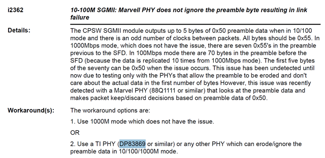

DP83867IS: Can SGMII work with TDA4VH SGMII
Part Number: DP83867IS
Other Parts Discussed in Thread: DP83869, TDA4VH
Please refer this post, as TDA4VH CPSW-9G SGMII send out wrong preamble, some PHY can't work with the CPSW-9G, DP83869 is confirmed in errata,  but not mentioned DP83867, please help confirm.
https://e2e.ti.com/support/processors-group/processors/f/processors-forum/1394352/tda4vh-q1-sgmii-expansion-board/5341766#5341766
As PHY datasheet doesn't mention whether it ignore preamble, seems need to check with PHY vendor one by one?
