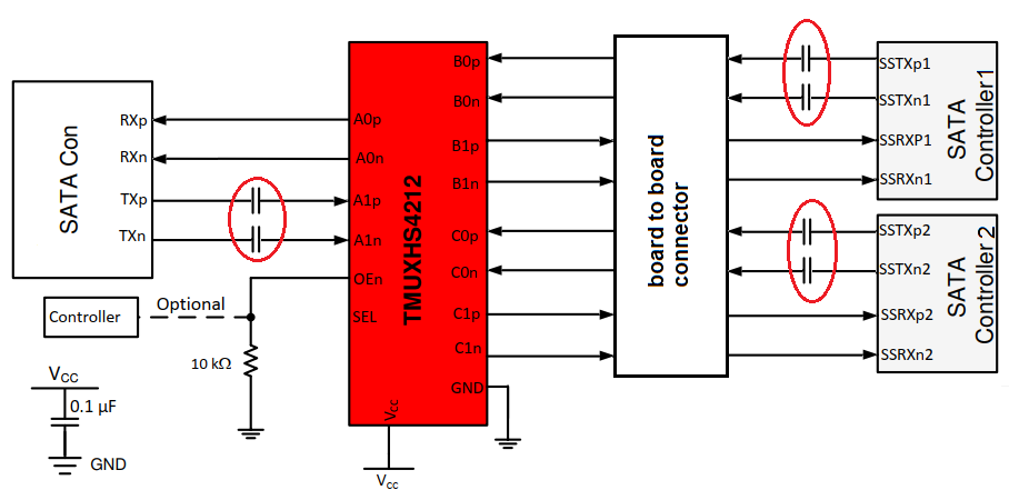

I would like to confirm two things.
Currently, we are using the mux for SATA signal.
Is the placement of the AC cap shown below acceptable?

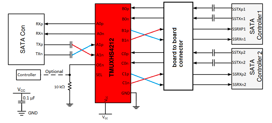

Second, since layout adjustment, is it can support polarity reverse as below?

Hi Jeff:
For AC cap, the placement looks correct.
For ploarity,, it's ok if you switch p/n on both sides of mux.
