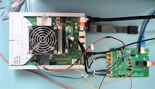

In our company, I am developing a network interface for the RFSoC ZU27DR based on the PHY DP83867E, that is using SGMII interface. I am using the original evaluation board from TI DP83867ERGZ-S-EVM, where I removed the R72 Resistor to apply VDDIO_EXT 3v3 from external power supply (about 35-38mA consume @ 3v3)
The FPGA is a module from KR (Knowledge Resources) with a KRC4700 carrier board. This carrier has no GT connectors (SMA or similar) and all PS-GTR are pined over a M.2 connector. I used and adapter M.2 to PCIe x4 to get access to the GT Lane 3, because the RefClk3 is the only one I can get access from a Si5332C clock generator.
Well I configured a Petalinux Project 2023.2 for this FPGA with the following device-tree:

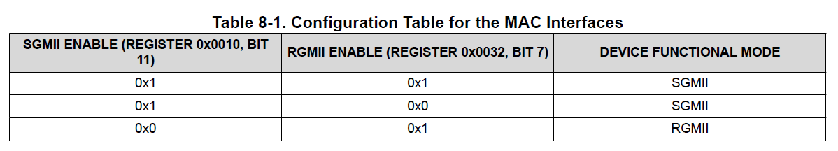

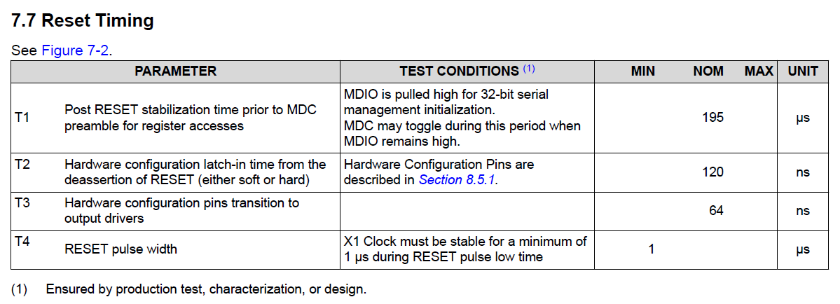

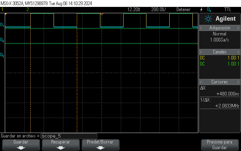

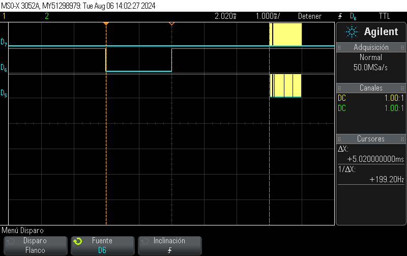

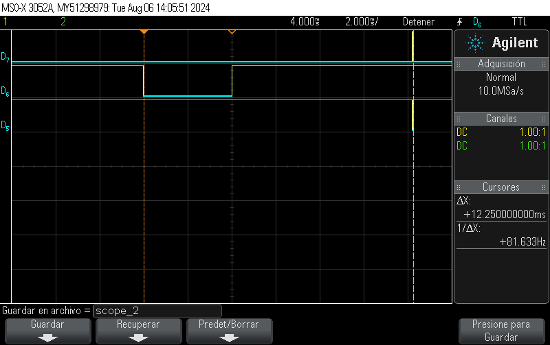

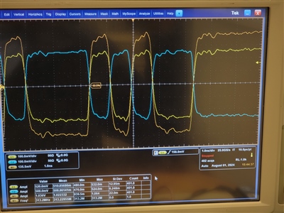

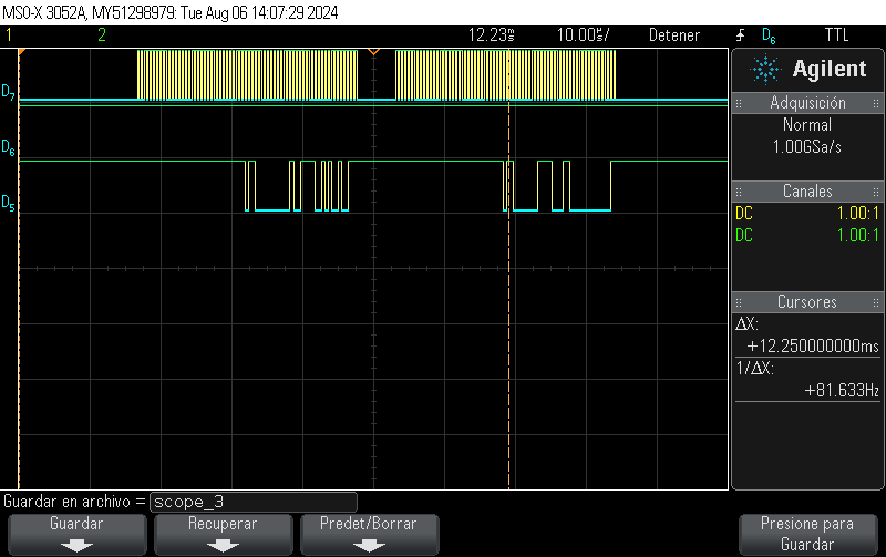

The reset is performed through an EMIO pin (pin EMIO0, or GPIO 78) and I observed it ocurrs once while FSBL and again after loading the kernel. The second reset (kernel) lasts double time than the first one (FSBL).
I fixed the ipaddr in the u-boot environment to try to ping from U-BOOT, but without success.
The GEM_CLK_CTL 0x00FF180308 register in the U-Boot shows the active mode for SGMII, but the GEM_CTRL 0x00FF180360 register indicates activity in GEM1, not GEM3 ????

Now are both modes SGMII (Reg: 0x10/Value: 0x5848) and RGMII (Reg: 0x32/Value: 0x00D3) enabled but no Next-Page Autonegotiation as received (Reg: 0x11/Value: 0xAF02).
Regarding the strapping, I observed that depends on reset time: for short (< 300µs) resets, bootstrapping is a bit random. PHY address is sometimes 0x4, other 0x8 or even 0xC. This is due to the presence of signal in SO pins, while strapping. Pins are in mode 0 (floating) in the evaluation board, so only the 2 LSB from PHY address are right. Just extending the reset time (about 2000µs) is the problem corrected.

  • Hi Alejandro!
    Thank you for submitting your query, I'll gladly assist in resolving this issue. You have provided a wealth of information, and I want to clarify a few items to make sure I am understanding the problem correctly.
    You are connecting your FPGA board to our 867-S-EVM and hoping to evaluate the SGMII connection. In both register logs, U-boot & PentaLinux, I can see that Reg 0x37 = 0, meaning that SGMII auto-negotiation never completed. You are however, receiving link status (Register 0x1 = 0x796D confirms link and Reg 0x11 = AF02 confirms 1000Mbps link speed). I want to confirm that SGMII link and MDI link (connector side) are independent, in your case we are linked up over the ethernet cable, but the SGMII link between our PHY and your FPGA is not established. This is the root cause of your communication issues.
    Before focusing on the SGMII connection, you mentioned that the strap values were changing after reset, and correctly identified the problem. Is this reset-strapping issue resolved? This needs to be stable before debugging further.
    Alvaro
  • Hola Alvaro! Wink
    Thanks a lot for your quick response and your guidance. Sorry for delay, but I am currently living in Germany (I come from Spain) and there is a lag time.
    I have a Raspberry Pi 4 as DHCP server to see when the DHCP Client is properly working.

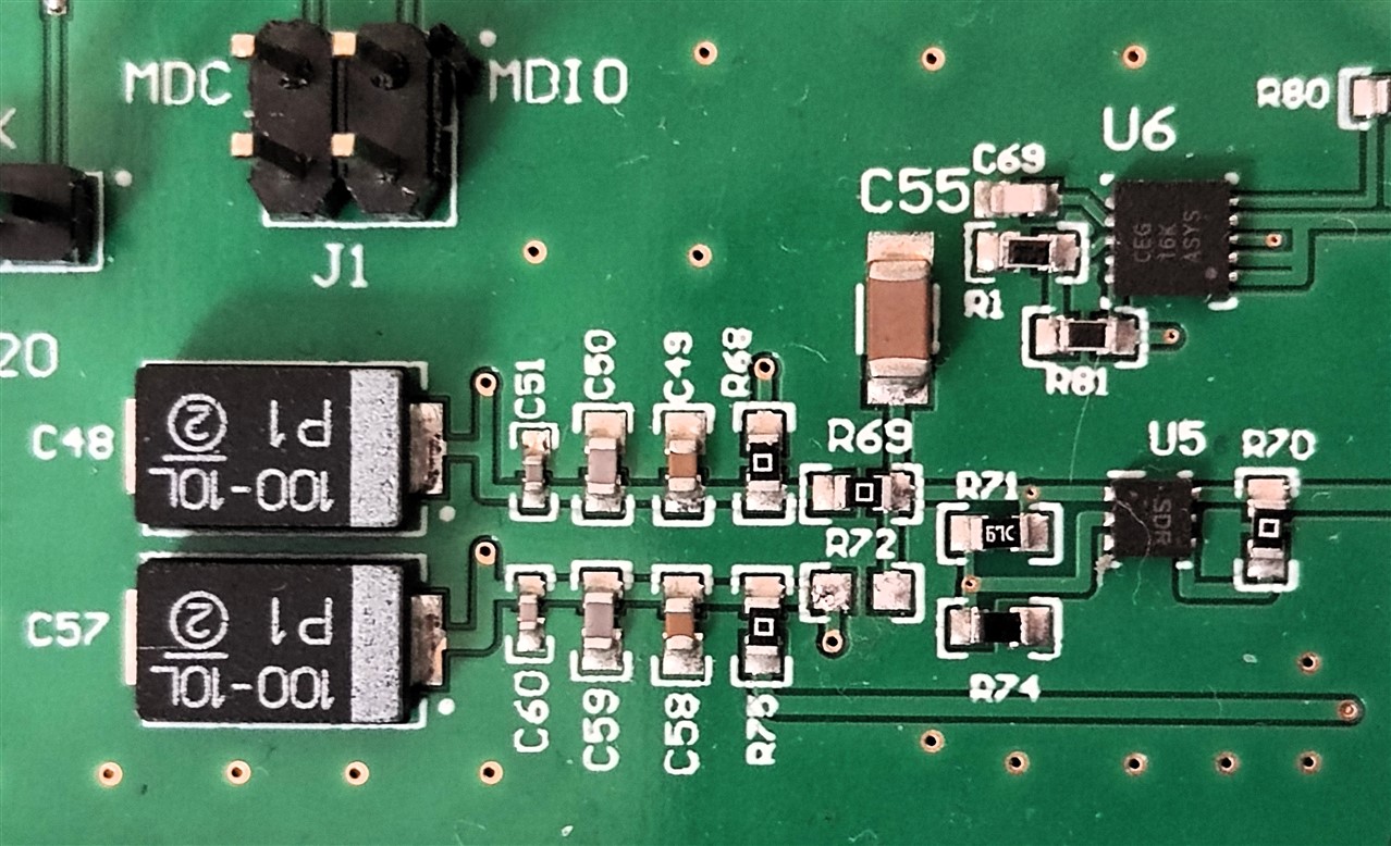

    Here you have a Photo with the Testbench I am working with:
    Testbench: KRC4700 and DP83867ERGZ-S-EVM SGMII
    I removed the R72 and sourced the VDDIO_EXT with 3v3 to make it compatible with my B87 Bank of the RFSoC
    R72 Remove and VDDIO_EXT=3v3

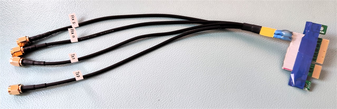

    The PSGTR on the KRC4700 (RFSoC Evaluation Board) are all in the M.2 Connector, so I used an adapter M2 -> PCIe x4,
    M.2 to PCie x4 Adapter
    There are 4x GT Lanes on the PCIe x4, but I can get the PS_MGTREFCLK3 only from the Si5332C clock generator in the carrier board. So I decided to use a self-made cable that get the GT Lane 3 from the PCI3 to 4x SMA connectors, and be able to connect to the PHY evaluation board,
    PCIe to 4x SMA (Tx_p, Tx_n, Rx_p and Rx_n)
    By this way, and configuraing the Si5332C to get the 125MHz clock for the PS_MGTREFCLK3, I configured the device tree with thephy parameter in the gem3

    In reference to the reset, yes, I found, after some tests, that one value around 2ms (reset-assert-us = <2000>;is stable, so I obtain the parameters as stated in the strap with PHY address 0x00. I tested the MDIO bus to make some measurements and here you have some screenshots:
     NOTE:     D7 MDC     D6 RESET     D5 MDIO
    U-BOOT Reset
    This is the first reset in the U-BOOT. The timing is 2ms, as specified in the device tree, and the clock MDC comes 3ms later.
    KERNEL Reset
    When the kernel loads, makes another reset, but now twice as specified in the device-tree (4ms) and the clock MDC starts about 8.25ms later, also much bigger time from reset deassertion to start of MDC.
    Messages after reset (MDC, MDIO)
    MDC timing
    There are 2 messages in the MDIO bus, I did not analize, but timing seems to be ok. The period of MDC is 480ns, that is a frequency of 2.08MHz.
    32 Clock Cycles MDC to MDIO
    Reset Timing
    There are 32 MDC clock cycles to wait for MDIO stabilization, as specified in the Figure 7-2 of the DP83867E datasheet (page 14)
    Regarding the registers, I confirmed your information from the register mapping in the datasheet, as you said, but I also observed a couple of things:
    The register 0x0032 shows that RGMII mode is enable, but also is enabled the SGMII mode, is this normal? Teoretically, the mode is SGMI if both modes are active as stated in the Table 8-1 of this datasheet,
    This happens after second reset, but after first one in u-boot, this register 0x0032 is 0x0000 (no RGMII).
    In both cases, in U-BOOt and in the kernel, the strap configuration register 0x006E takes value 0x8820, and it enables RGMII mode,
    RGMII and SGMII enabled
    Maybe this has any effect in the association of the GT Lane 3 with the GEM3? But in U-BOOT is the register 0x0032 null and even so no ping.

    Glad to hear back from you. Regarding Reg 0x10 & Reg 0x32, you are correct, the data sheet mentions that SGMII has higher priority, as long as SGMII is enabled we are in the correct mode. Side comment, I believe you are using an older version of our data sheet, please find the most up to date one online.
    Thank you for showing me the set up! Focusing on the SMA to PCIE adaptor you made, would it be possible to use a scope to confirm the SGMII output from the FPGA? The SGMII output from the PHY can also be confirmed by plugging the EVM into a scope. Below is a scope shot of the SGMII signals from the DP83869EVM, a similar part to the DP83867.
    Channel 1: SO_P
    Channel 2: SO_N
    Channel M1: CH1 - CH 2
    Alvaro
