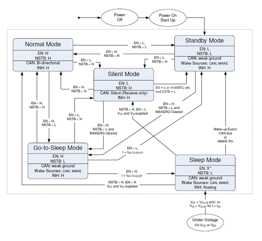

Hello expert,
Do you have the flow chart for normal / sleep / standby mode? I checked with datasheet and there is only below table but customer would like to know how about CANH/CANL receive WUP. So if there is flowchart, that would be easier to understand. Thanks a lot!
