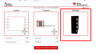

TI Team, do we have STEP 3D thermal model for TLIN1027DRQ1? This is needed for PCB system-level thermal simulations.
I found online 3D model, but it does not seem to have thermal info inside....

Piotr,
No, this is a STEP 3D model just used for building 3D designs (e.g. PCB renderings). It does not have thermal data.
There is thermal information in the device data sheet that can help with thermal analysis. There is also a good application note HERE which can help give further context to these numbers.
