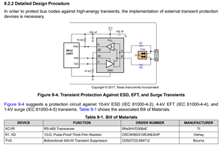

Datasheet Figure 9-4 indicates 10ohm series resistors on A/B line for transient protection.
Any issues if customer steps up R1 and R2 to 300ohm resistors?
