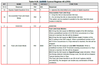

Would you please tell me the link down detection conditions for DP83822I and DP83848K and the documents that describe them?
DP83822I has the following description, but this is when FLD is enabled.
For DP83822I, I would like to know the link down detection conditions when FLD is disabled.
