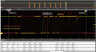

When the PHY is in normal operating mode and the MAC periodically reads the PHY's registers using the SMI interface, abnormal glitches appear on the MDIO signal after the MAC changes the direction of the MDIO signal during a read operation. Although this does not affect functionality, what could be causing this issue? At this time, the MAC's MDIO is in high-impedance input mode.
Best Wishes!

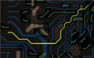

The MDIO is connected directly to the MAC through a pull-up resistor, and the power supply for the pull-up is stable according to the test waveform. There are no high-speed signals near the MDIO trace, so it doesn't seem to be interfered with by surrounding traces. This is because the abnormal glitch only appears in the second half of the read operation, while the rest of the time it is a stable pulse waveform or idle high state.
