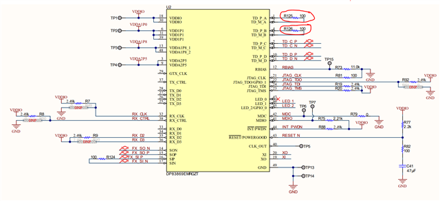

Hi team,
I’m working on a 100M media converter (100BASE-TX to 100BASE-FX) using the DP83869 PHY chip. I have a doubt about termination for suppressing unwanted noise. On the magnetics connection side, I’m using the 10/100BASE-T single port surface mount magnetics instead of 1000BASE-T. Hence, channels A and B will be unused. However, we connect one 100-ohm resistor for termination. Is this fine? Can you share your comments, please?

    Thank you for submitting your query. Firstly, is there any reason why you chose to use Channels C & D for 100Base-TX instead of Channels A & B? Note that Mirror Mode will need to be enabled for Channel C & D to function.
    Secondly, the 100Ω termination is okay, but unnecessary. If the extra two pairs are going to be unused, they can be left floating.

    Thank you for answering my question. Yes, we enabled mirror mode for routing feasibility. Based on your comments, I believe there is no need to add any termination resistors.
