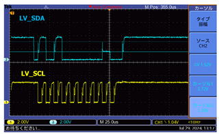

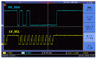

HV_DDC_SDA is receiving ACK correctly.
ACK cannot maintain the 'L' level on LV_DDC_SDA after passing through the DDC buffer inside the TDP1204.

    The reason we see this bump on the LV side is due to the hysteresis and thresholds of the DDC buffer.
    In the case of the ACK. The data is being sent from the slave to the master HV_DDC -> LV-DDC.
    When HV side falls first and goes below 1.6-V, a CMOS hysteresis input buffer detects the falling edge, turns on the LV driver, and pulls LV down to approximately VLVOL = 0.16 × VIO. The LV side pulldown is not enabled unless the LV voltage goes below VILC.
    Assuming a 3.3V VIO:
    VLVOL = 0.16 * VIO = 0.528V
    VILC = 0.08 * VIO = 0.2634.
    The issue you are running into is that the low level for the LV side is not less than VILC, so the LV side pulldown in not enabled. This results in the internal pullup raising the voltage. Try to keep the low level of the LV_DDC communication below the VILC value.
  • Hello Vishesh,
    When we checked the customer's configuration, we found that there was a 2.2kΩ pull-up resistor on the LV side of the TDP1204.
    It was connected in parallel with the 10kΩ built in TDP1204, resulting in a strong pull-up of approximately 1.8kΩ, and I found that I could not drive it to the 'L' level.
    I am sorry to have caused trouble.
