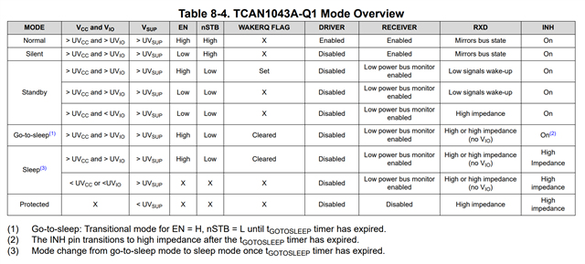

What is the value of TCAN1043ADMTRQ1 RXD pin under the following conditions?:
  1. VIO is powered, nSTBY is high, EN is low.
  2. VIO is powered, nSTBY is high, EN is high.
  3. VIO is powered, nSTBY is low, EN is high.
  4. VIO is powered, nSTBY is low, EN is low.
Looking into datasheet RXD states vs. nSTBY and EN changes are in Table Table 8-4, but waht does “Low signals wake-up” RXD state mean?
