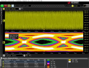

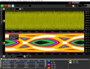

I use 8 DS100KR800 on a design. I use them in master mode sharing a same EEPROM, and with 3v3 mode.
The signals integrity is reduced by the repeaters. I have the same behaviour for each channel.
The registers impact  the redrived signals.
I have keep only one channel active for make measurements.
Best results are obtained by having an equalization to 0 and de-emphasis to 0.
Input signal:
input signal

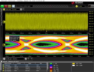

Output signal with equalization to 0 and de-emphasis to 0.
Increasing equalization or de-emphasis reduce signal integrity.
Output signal with equalization to 0 and de-emphasis to -1.5 dB.
Output signal with equalization to 1 and de-emphasis to 0
I tested all suggested equalization values up to FR4 20 inch 4-mil trace.
I have measured supply noise up to 50MHz, I have less than 10mvpp on bandwidth.
Do you have any suggestion to improve eyes opening.

  • Hi Robin,
    What is the insertion loss of the channel connected to the receiver of DS100KR800?
    Lucas
  • Hi Lucas,
    Between the signal source and DS100KR800, we have cable, backplane , PCB... I don't have insertion loss of all parts of the chain.
    I will see to perform an insertion loss measurement.
    The differential measurement are performed on the coupling capacitors in input and output of DS100KR800.
    Robin
  • Hi Robin,
    If I'm understanding correctly, are you measuring the eye diagram by probing the AC coupling capacitors before and after the redriver? This isn't a very precise way to measure eye opening. A better method is to plug an HCB into your SFP connector and connect the electrical signal to your scope.
    Insertion loss measurement or simulation would be helpful as a sanity check on the EQ setting you're using. The EQ boost level should roughly match the amount of insertion loss on the receiver channel.
    Lucas
  • Hi Lucas,
    We have made a measurement of S parameter.  I can provide s4p file.

    I have perform new measurements inside the SFP cage with termination.  I do not have an available HCB. The measurement is more accurate, the behavior is still the same, when I increase equalisation in DS100KR800 register the eyes are more closed.
    EQ=0x00
    EQ=0x01
    Robin

  • Hi Robin,
    What TX pre/post emphasis are you setting on your 10G-KR IC?  Also, do you have AN and LT disabled?
    I see that your insertion loss is about 10 dB.  By default, the DS100KR800 provides around 5 dB of boost.  EQ=1 applies around 8.7 dB of boost.  If you have TX equalization on your 10G-KR IC, it's possible that this over equalizes the signal.  However, it's surprising to see the "hits" within the eye of the EQ=1 case.  For over-equalization, we'd expect a gradual degradation of the eye rather than a sudden appearance of lots of "hits" within the eye.
    Drew
  • Based on your informations, I solved the issue. I have reduced emphasis setted on 10G-KR IC, and over-equalization.
    Now, I have a good eyes opening.
