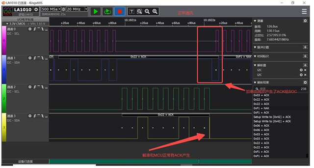

my customer use DS90UB947 pair with DS90UB948, now they find the I2C communication fail problem.
below is the test scope :
in normal condition, I2C work normal, MCU(948 side) can reply the ACK, after 130us, SOC will get the ACK(947 side)
first and second  channel is 947 I2C side
third and fourth channel is local MCU and 948  I2C side

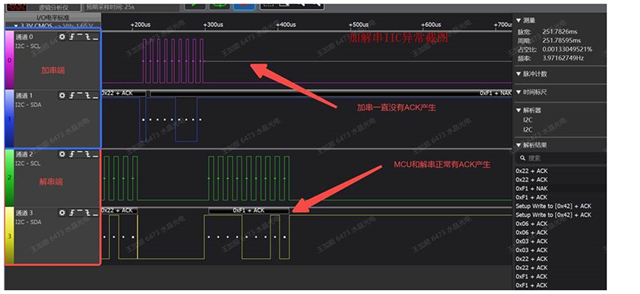

in abnormal condition:
Local MCU can get the ACK and reply, but after 250ms ,SOC don't get the ACK and time out , so the I2C fail.
    Could you provide more information as to when this issue is occurring? More specifically, is it during the bring up process? Have both the SER and DES been initialized? Is I2C communication stopped immediately after some registers are set? in addition, does the customer observe LOCK loss at any point?
    Also, what exactly is happening in the 2nd scope capture, is MCU on Des side trying to write to the SoC through back channel?
    Or Is the SoC on Ser side trying to read some register status from the MCU through the forward channel?

    sorry too late to reply you. To clear this problem, the problem is SOC can't get the MCU data, customer find mcu pass the data to 948 but don't see the ack in the 947side.
    below is the feed back from customer based your question:
    1 all the 947 have this problem
    2 the probability of occurrence is 10%,
    3 a single system
    4 947 config(0X03,0XDA) (0X17, 0X9E) 948 config(0X02, 0X80) (0X03, 0XF8)(0X05,0X9E)
    5 947 set is 100k
    6 948 set is 76K
