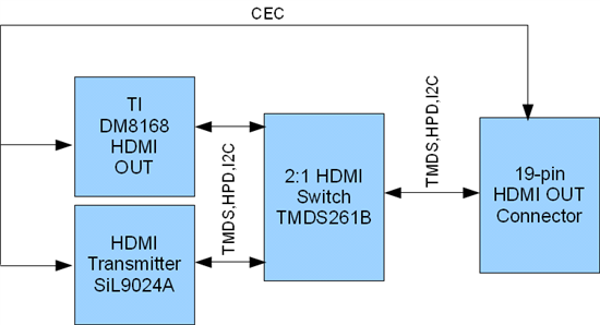

Thanks for sharing links. I would like to re-open the post.
As shown in attached image, we want to switch 2 HDMI devices by TMDS261B. TMDS261B uses only TMDS[1:0],HPD[1:0],I2C[1:0] pins for switching. But it does not has CEC[1:0] pins.
Can we short CEC pins of both HDMI devices and give it to 19-pin HDMI connector (as shown in image)?
Ronak.
CEC, from what I understand, does not need a switch, because all participants are on the exact same bus. So yes, the diagram you have shown should be correct. TI's HDMI switches have nothing to do with the CEC signals.

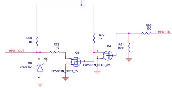

According to the HDMI interface spec, the standard 3.3V output should be adequate. We have seen issues with some equipment which was the reason for the added circuit. My recomendation would be to have a 5V signal for HPD.
