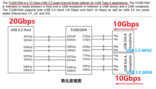

I`d like to know whether TUSB1004 could use in full speed for both of two channels? 20Gbps total in one direction.

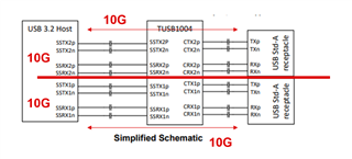

But TSUB1104 is USB3.2 GEN2 that supports 1 type-c (only one set of SSTX SSRX works at a time). Are you sure it can also be used in two USB3.2 GEN2 type-A scenarios, I don't know if it can meet the needs of two ports running full 10G at the same time. The Datasheet also says that it supports 20G throughput (10G in one direction).

To clarify, what is the configuration in question? Two Type-A ports or a Type-C port? For two Type-A ports the TUSB1004 will support 10Gbps on each port, for Type-C the TUSB1104 will support 10Gbps on each lane.
