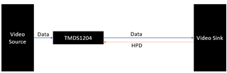

    A source application will look something like this:
    In this case the HPD will serve as the flag determining if a video sink is connected as the HPD signal comes from the sink.

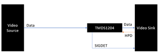

    A sink application will look something like this:
    In this case the SIGDET signal will determine is a valid signal is being received by the TMDS1204

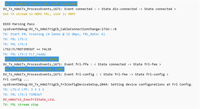

    Are you able to share the DDC log of the link training failure?
    The problem I am currently facing is that the FRL link training often fails, and the reason is that the FRL training is initiated without waiting for RSEN to become effective.
    The sink is the device that sets the FLT_ready bit to initialize the link training process. RSEN should not be needed for link training to be a success, as link training should not start unless the sink initiates it.
  • I reviewed the FRL link training logs and found that the FRL training failure occurs at LTS:3 TIMEOUT. The FRL LTS:2 FLT_ready completed normally.
    This is likely a design issue with the monitors, but testing two monitors showed the same phenomenon.
    I observed a basic HDMI 2.1 generator that always waits for RSEN to be valid before starting to output signals and consistently completes the FRL training successfully. This basic generator is not of my design, so I cannot access its logs.

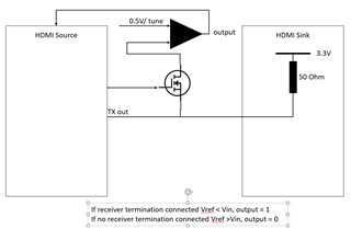

    If you want you can create an external RSEN circuit as follows:
    However, it seems that RSEN will not solve your issue based off of the DDC logs and that the link training fails across multiple sinks. This may be signal quality issue and I push that you verify the source and do a HDMI2.1 compliance test.
