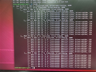

I am currently developing hardware using the Raspberry Pi CM4 and TI USB devices.
The diagram below shows a simplified top-level design of the hardware I am working on.
All USB HUB ICs are configured not to operate the USB power switch control.
The diagram below shows the hardware block diagram and a photo of the devices recognized on Linux.
I am currently facing a few issues with this hardware configuration:
Problems
  1. After initial power-up, all devices below the CP2108 devices (8 units) and the TUSB4020 (Yellow box) in the diagram are recognized by Linux. However, after 30 minutes or a random period, the connection drops, and the devices are either re-recognized or fail to reconnect. Please identify any potential issues in this hardware configuration.
  2. I used the TUSB211A to achieve a longer communication distance, but communication fails beyond 3 meters when using UTP cable. What additional circuits or devices are necessary to ensure communication over a distance of more than 10 meters?
    The solution must be implemented within the PCB, without using repeater or bridge devices in the middle of the line.

  • After initial power-up, all devices below the CP2108 devices (8 units) and the TUSB4020 (Yellow box) in the diagram are recognized by Linux. However, after 30 minutes or a random period, the connection drops, and the devices are either re-recognized or fail to reconnect. Please identify any potential issues in this hardware configuratio
    what cable length used for this issue happened, 3m?
    what connection is lost, yellow box?
    TUSB216I can work with 5m cable, for 10 m, you may need two USB2 redriver.
    A USB hub system  can  work  with  127 devices, but not  sure if  how many devcies CM4 can support, can you  remove one TUSb4041 and test again?

  • Q. What cable length used for this issue happened, 3m?
    A : We used UTP cables with lengths of 1m, 1.5m, and 3m.
         During this time, the connections of TUSB4020 (Y-BOX) and CP2108 (Y-BOX) were randomly disconnected.
         However, when using USB cables of 1m and 2m, there were no disconnections for two days.
    Q. What connection is lost, yellow box?
    A : Most of the disconnections occurred with the CP2108 (Y-BOX), while the TUSB4020 (Y-BOX) experienced disconnections at a lower probability.
    Q : If we are to use two USB 2.0 redrivers, how should they be implemented in the circuit?
          Could you provide any related application notes or reference circuits?
    Can you  remove one TUSb4041 and test again?
    I can remove one TUSB4041 and run the test.
    But since I'm only using 2 out of the 4 channels of each TUSB4041, removing one of the two TUSB4041s will ultimately allow me to test only 2 channels.
    Thanks.
  • Hi Jihong:
       It seems the issue is cable  related, let me find out the report with 10 m cable.
       This test is just to check if the issue was caused by bandwidth or not.
