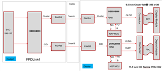

DS90UB983-Q1: IVI and instrument cluster black screen 983 problem consultation
Part Number: DS90UB983-Q1

Hi team,
Tier1:Neusoft
OEM:FAW
,The customer's instrument panel has a double black problem. Please see the attachment for all the registers of 983.
I took a quick look and found that VP sync was abnormal, but the error was not abnormal, and Htotal was all 0. Since no error abnormality was detected, no recovery measures were taken.
Then I looked at the APB registers and found that the link traning APB_DPCD_LANE01_STATUS Register (Address = 0x43C) and APB_DPCD_LANE23_STATUS Register (Address = 0x440) registers were both 0x00.
The APB_MSA_HRES Register (Address = 0x500) and APB_MSA_VRES Register (Address = 0x514) registers were also 0x00.
There is no traning and DP video stream. In this case and the register status, can you confirm the specific problem? How to deal with it?
(The customer has incorporated ERRATA of VP SYNC.)
